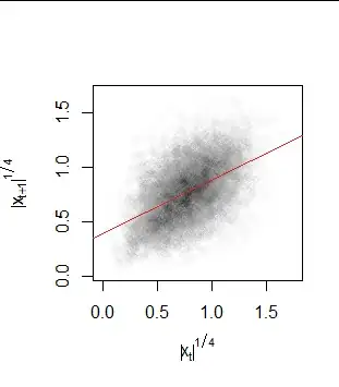

To help the intuition, here is a scatterplot of the absolute values in the preceding figure (shown on fourth-root scales to remove the skewness from the marginal distributions; if you like, the function involved is $f(x) =\sqrt[4]{|x|}$). The red line is the least-squares fit to these fourth roots. The correlation is obviously nonzero.
Figure 2
