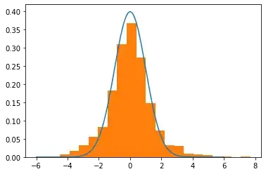

HMC_1
But it breaks when I change sigma to 2.
# Generate samples
mu, sigma = 0,2
trial = HMC(mu=mu,sigma=sigma,path_len=2,step_size=0.25)
What the dist should looks like
lines = np.linspace(-6,6,10_000) normal_curve = [normal(x=l,mu=mu,sigma=sigma) for l in lines]
Visualize
plt.plot(lines,normal_curve) plt.hist(trial,density=True,bins=20) plt.show()
HMC_sampler2
Any ideas? I feel like I'm close to "getting it".

  • Wow, this was so helpful! Btw, I found a couple bugs in my code (it works now! Will update this weekend.) Thinking in terms of gas in a chamber, rather than a satellite, was really helpful. – mjake Aug 29 '20 at 00:39
