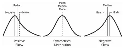

What you have read is the good answer: most of the time the skewness will not depend on where most of the data is. Although we can take other definitions, the skewness is defined by $$sk(X)=E\left[\frac{(X-E[X])^3}{\sigma^3} \right] $$ Hence if there are data that are far away from the mean (or median) of the distribution (in your boxplots, there are points between 6 and 9, which is very distant from the median) then these points will weigh a lot in the computation of the skewness and the skewness will be positive, which can be the definition of right skew. Visually think about this wikipedia plot plot of skewness and always from wikipedia, the definition of positive skew is : The right tail is longer; the mass of the distribution is concentrated on the left of the figure. The distribution is said to be right-skewed, right-tailed, or skewed to the right, despite the fact that the curve itself appears to be skewed or leaning to the left; right instead refers to the right tail being drawn out and, often, the mean being skewed to the right of a typical center of the data. A right-skewed distribution usually appears as a left-leaning curve.

    Many textbooks contain diagrams like yours, but while the ordering of mode, median and mean is commonly found it is not inescapable, as some texts and papers also explain. One quite common exception is that mean, median and mode can be identical in a skewed distribution. – Nick Cox Aug 04 '20 at 08:11
    Indeed examples of various other orderings (and of equality) occur in some answers on site. – Glen_b Aug 04 '20 at 10:59
  • yes I agree I just used this graph to show examples of left-skewed and right-skewed to illustrate the definition. – TMat Aug 05 '20 at 06:58
