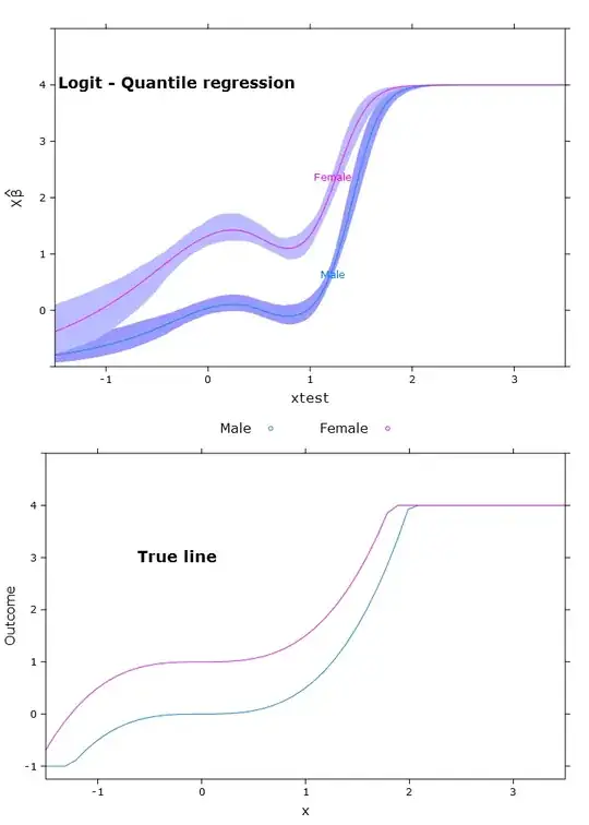

logit_rq_plot <- plot(transformed_p,
             se=T,
             col.fill=c("#9999FF", "#BBBBFF"),
             xlim=my_xlim)
The logistic quantile regression that has a very nice bounded prediction:
Here you can see the issue with the Beta's that in the retransformed fashion differ in different regions (as expected):
