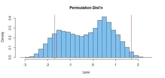

Using the test statistic of the two-sample Welch t test as metric, but not assuming it has a t distribution, I did a permutation test as shown below, which also shows no significant difference in location between the two samples (P-value $0.13).$ [In R, sample, without extra parameters permutes, the order of elements of its argument.]
t.obs = t.test(x ~ gp)$stat
set.seed(2020)
t.prm = replicate(10^5, t.test(x~sample(gp))$stat)
mean(abs(t.prm)>=abs(t.obs))
[1] 0.12895
The histogram below shows the permutation distribution of Welch's t statistic $T.$ The two-sided P-value is the area in the histogram in the two tails outside the vertical lines. [If a t test were appropriate, one would expect the permutation distribution to have nearly a t distribution, which is not true here.]
hist(t.prm, prob=T, br=30, col="skyblue2", main="Permutation Dist'n")
pm = c(-1,1); abline(v = pm*t.obs, col="red")
