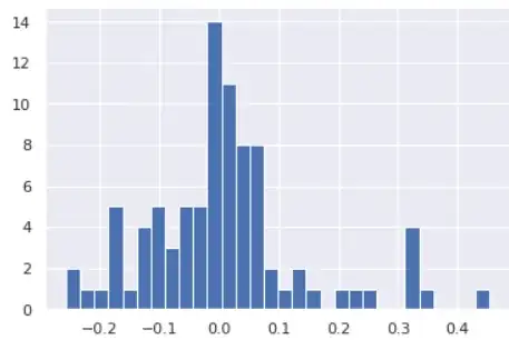

I have this model in machine learning, and in the end, I calculate the Relative Error to find out how off the model is from predicting based on the real data. This is the histogram that I obtain from the model.
What to do when the Relative Error curve of a Model in the Machine Learning is not normally distributed? Does this mean that the model is not well trained?

On the one hand, you have many bins (30) for very few data points (86). Even if your underlying data are normally distributed, a histogram with such a high bins/data ratio will look pretty bumpy, for instance:
example histograms
R code:
nn <- 86
n_bins <- 30
par(mfrow=c(2,3)) for ( ii in 1:6 ) { set.seed(ii) # for reproducibility hist(rnorm(nn),breaks=n_bins,xlab="",main="") }
More reading at Understanding an abnormal grade distribution.
On the other hand, I assume your relative errors are $\frac{y-\hat{y}}{y}$. It may well be that they cannot be normally distributed at all - for instance, if you know that $y>0$ and you very sensibly truncate your predictions from below at 0. Then the relative error cannot be larger than 1. But any normal distribution has unbounded support. So your relative error cannot be normal.
Bottom line: your histogram does not give cause for concern.
