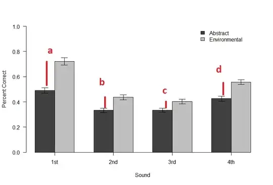

I regressed accuracy (of participants, sbj) on cnd (condition, having two levels: abstract vs. environmental), and sound (having four levels: 1st,2nd,3rd,4th). There is an interaction, so I analysed data from each condition separately. Results were similar in both conditions: There was an effect of sound, and post-hoc comparisons (following this post) suggested these differences : (1st)>(4th)> (2nd or 3rd), for both conditions, as can also be seen on the graph below: enter image description here

My question is how can I compare the differences between conditions at each level of sound.

But this not what I am looking for. I need to conduct multiple comparisons on the differences between means. To be more clear(please see the image), I need to check if a and d are greater to b and c.

  • You need a contrast of contrasts. so save the first set of contrasts and contrast them: con <- pairs(m); contrast(con, list(ab.vs.cd = c(1,1,-1,-1)/2), by = NULL) – Russ Lenth Jul 28 '20 at 23:24
  • Thanks Russ. But I need to do all six comparisons, namely: a vs, b, a vs. c, a vs. d, b vs. c, b vs. d, c vs. d. Not just compare a+d vs. c+d (I should have been more clear). Any thoughts? – fotisfotiadis Jul 29 '20 at 07:10
  • That isn't what you asked, but it's even easier: pairs(con, by = NULL). Or contrast(m, interaction ="pairwise", by =NULL). This stuff is all pretty well documented. Please read the vignetter on interactions. – Russ Lenth Jul 29 '20 at 12:30
  • Russ, thank you so much for the response, that was exactly what I was looking for. I really appreciate your advice! (And I will read the vignetter you suggested). Regards – fotisfotiadis Jul 29 '20 at 18:38
