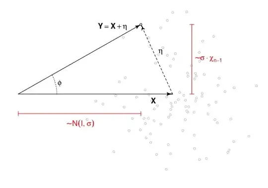

Geometric view of problem, and rotation
We can view the problem by considering the radial and transverse components of the distance of the vector $Y$. These transverse and radial components are defined with respect to the vector $X$.
This means that the direction of $\mathbf{X}$ is not really important, because we consider the situation relative to $\mathbf{X}$
This view is easier when we rotate the vector $\mathbf{X}$ such that it is aligned allong one single axis. For instance, in the code below we generate/simulate samples with the vector $\mathbf{X}$ having only the first component non zero, $\lbrace l,0,0,\dots,0,0 \rbrace$. We can do this without loss of generality.
In the case that $\boldsymbol{\eta}$ has i.i.d. $\eta_j \sim \mathcal{N}(0,\sigma)$, then the distribution will be spherically symmetric. This means that after the rotation the distribution of the rotated $\boldsymbol{\eta}$ can still be considered to have i.i.d. components.
See the image below where we rotate the situation (to align the vector $\mathbf{X}$ to a basis vector). On the left we see the situation for the complex situation (not all $\eta_j$ identical but with different variance) and on the right we see the situation for the simplified case.
geometric view of rotation
Now we can attack the problem by focussing on the angle, $\phi$, between $\mathbf{X}$ and $\mathbf{Y}$. The actual direction of $\mathbf{X}$ does not matter, and we can parameterize the distribution by only the length of $\mathbf{X}$, say $l$.
geometric view
The angle $\phi$ can be described by its cotangent, the ratio of the the radial and transverse parts of the vector $Y$ relative to $X$.
Note that, with the rotated vector $\mathbf{X} \sim \lbrace l, 0, 0, \dots, 0, 0 \rbrace$ the components of $\mathbf{Y}$ are easier to express
$$Y_i \sim \begin{cases} N(l,\sigma)\quad \text{if} \quad i=1 \\ N(0,\sigma)\quad \text{if} \quad i\neq 1\end{cases}$$
and we can easily express the radial part, $Y_1$, and the transverse part, $\lbrace Y_2,Y_3, \dots, Y_{n-1}, Y_{n} \rbrace$. And the lengths will be distributed as:
  • The length of the radial part is a Gausian distributed variable
  • The length of the transverse part is a scaled $\chi_{n-1}$ distributed variable.
    (The image is in 2D for simplicity of plotting, but you should imagine this in a multidimensional way. The length of the transverse part is a sum of $n-1$ components. A similar construction is shown here where a 3D visualization of the angle is shown)
This ratio of the radial and transverse part, multiplied with $\sqrt{\nu}$, lets call it $T_{l/\sigma,nu}$, has a t-distribution with non-centrality parameter $l/\sigma$ and degrees of freedom $\nu = n-1$ (were $n$ is the dimension of your vectors).
note: this t-distribution occurs because the radial part and transverse part are independently distributed in the simplified problem. In the generalized problem this will not work (although the limit, large $n$, may still be useful when we appropriately adapt the scaling factor). See this in the first image on the left, where after rotation the distribution of $Y$ shows a correlation between transverse and radial part, and also the transverse part is not anymore $\sim \chi_{n-1}$, because the individual component may have different variance.
The transformation between $T_{l/\sigma}$, which is the cotangent of the angle (multiplied with $\sqrt{\nu}$), and your dot product $\rho$, which is the cosine of the angle is:
$$\rho = \frac{T_{l/\sigma}}{\sqrt{\nu+T_{l/\sigma}^2}}$$
$$T_{l/\sigma} = \sqrt{\nu} \frac{\rho}{\sqrt{1-\rho^2}}$$
