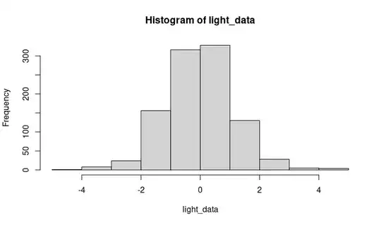

I am having some issue understanding the behavior of such distributions when generating random numbers.
I was under the impression that heavy tailed distributions have "heavier" tails, so there is more probability to observe higher values, whereas lighter tailed distributions have values more concentrated in the body of the distribution. Is this correct? I tried to sample from a Cauchy distribution (heavy distribution) and from a t-distribution (light) and plot the histogram. I am confused because I expected exactly the opposite of what I get. Here some example in R (the same results can be replicated with any statistical software)
set.seed(999)
heavy_data <- rcauchy(1000) light_data <- rt(1000, 10)
hist(heavy_data) hist(light_data)
cauchy
t-student
It looks like that from the cauchy distributions, all the observations are in the body with almost anything in the tails, whereas for the t-distributions we have a wider spread of data, so in the body as well as in the tail.
Could anyone clarify this?

Cauchy. The reason for the the strange histogram from Cauchy data is precisely because you are getting many extreme values in the tails--too sparse and too extreme to show well on your histogram. A data summary or boxplot might be more useful to visualize what's going on.

The standard Cauchy distribution (no parameters specified) is the same as Student's t distribution with DF = 1. The density function integrates to $1,$ as appropriate, but its tails are so heavy that the integral for its 'mean' diverges, so its mean doesn't exist. One speaks of its median as the center of the distribution.
Student's t, DF = 10. There is nothing particularly unusual about Student's t distribution with DF = 10. Its tails are somewhat heavier than for standard normal, but not so much heavier that it's hard to make a useful histogram (no truncation needed). And its mean is $\mu=0.$

Your intuition is correct but your pictures are inaccurate. hist by default generates the limits of the x-axis based on the range of your data. Your Cauchy data ranges from about -400 to 400, whereas your t_10 data ranges from about -5 to 5. So you need to specify a common x-axis to compare. A related problem is the bin size. The bins of the Cauchy data are big, driven by the range of the data. A simple way to make them more comparable is to increase the number of bins:
hist(heavy_data, xlim = range(heavy_data), breaks = 600)
hist(light_data, xlim = range(heavy_data), breaks = 200)
