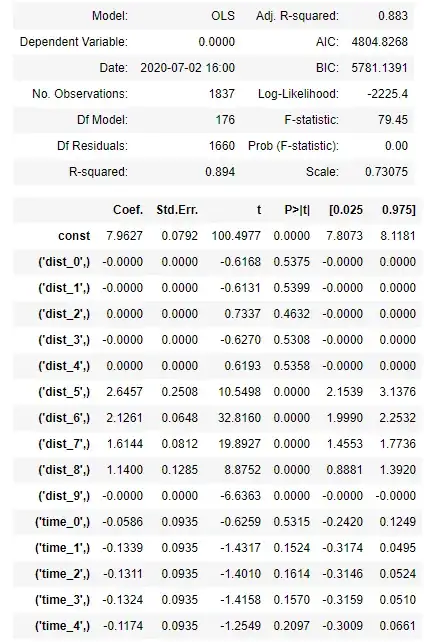

I am having a problem with OLS regression. I am doing a relative time model (leads and lags model) to prove the robustness of my Difference in differences model. Problem is that some of my coefficients and standard errors are having 0 value. I think it means that there's something wrong with the model but I don't know what's causing the problem. Here are the results.
dist_5 is when the treatment effect first appeared. I want to prove that there is a positive significant effect starting from dist_5 (lags) and no significant effect on the leads.
Thank you
+) I'm running the model with python and the result is too long to attach so I had to cut the rest of the coefficients.
These are the coefficient of each parameters; enter image description here
and these are the standard error of the parameters; enter image description here
This is what the result summary looks like (not full result); enter image description here

  • Are you running the model using spreadsheet software or just using it to present the results ? Can you show us the actual results using actual statistical software ? – Robert Long Jul 02 '20 at 07:03
    @RobertLong I just edited my question and added images of the results. – kyrhee Jul 02 '20 at 07:20
  • Ok, so it's not that they are zero. It's just that they are very small, right ? – Robert Long Jul 02 '20 at 07:26
  • @RobertLong Yes. The coefficients and standard errors of the leads are too small (near zero) that I think I must have done something wrong or misunderstood the relative time model (leads and lags model). I saw some papers regarding the model but none of them had coefficients and std errors that were nearly zero. – kyrhee Jul 02 '20 at 07:30
    I think its unlikely that we can tell what, if anything, is wrong, without seeing the data. It looks like the results support what you are trying to "prove", but please note that you can't "prove" anything with statistics – Robert Long Jul 02 '20 at 07:36
  • @RobertLong I have done DID analysis of 167 individuals (150 of them treated) and my DID analysis turns out to be significant. But, I want to prove the robustness of the model so I developed the relative time model and tried to see the coefficients of the leads and lags of the time periods (to see if the treatment effect is influential starting from the treatment period). For more context, the unit of analysis is video content and the DV is the views of video content and it is log-transformed. I also added program fixed effects and time fixed effects to the model. I hope this helps. – kyrhee Jul 02 '20 at 07:42
  • Ok that's good information and should be in the question. However it doesn't really help answer it. Why do you think these estimates should not be very small ? Have you plotted the data and does that give any insight ? – Robert Long Jul 02 '20 at 07:51
The standard errors of your estimated coefficients
The standard errors of your estimated coefficients, $\hat\beta$, are estimated according to:
$$\widehat{s.e.}(\hat\beta_j ) = \sqrt{s^2(X^TX)_{jj}^{-1}}$$
where $s^2$ is an estimate of the deviation/variance of the noise and $X$ is the matrix of your regressors.
  1. In other words the standard error of the coefficient $\beta_j$ scales with the inverse of the root mean square of the column/regressor $X_j$. (you should be able to verify this easily which helps you with debugging)
  2. Note that these are marginal errors and the formula can be generalized to provide a covariance matrix of the variance of the estimated coefficients. If there is correlation then the marginal errors might be very large but will not reflect the distribution of error correctly

Check the root mean square size of your regressors
So in your situation you probably have some very large (root mean squared) size for several of the columns/regressors $\vert X_j \vert$. And that is why the parameters (and the estimated error) have such low values.
(I would also suspect that there might be some computational errors, however this is difficult to inspect with the given information. Anyway, at least you can now verify with this answer whether it is the standard case, ie. the relation with $X^TX$)
In addition: Possibly you might want to do a mixed effects model? Those fixed effects per user do they make sense to be considered fixed effects, or can we more specifically regard them as following a normal distribution?
  • Thank you for giving a clear and detailed reply. I tried computing the standard errors manually and found out that there was nothing wrong with the regression and the problem was coming from another source. Anyways, your answer was very helpful. Thanks! – kyrhee Jul 03 '20 at 09:50
