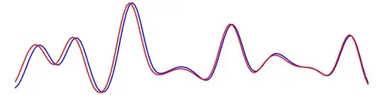

I need to calibrate physical devices to align their measurements to a common nominal base. Figure below depicts curves of measurements to be aligned.
devices differences
As it can be seen from the picture the difference is mainly in shifts on the x axis which I assumed to be locally linear.
I have attempted sampling a few points along the axis and searching for a linear shift minimizing RMSE between the curves.
This solution seemed to cause over-fitting, in most cases I got measured points $x_1 < x_2$ being "fixed" to $x_1^\prime , x_2^\prime$ correspondingly such that $x_2^\prime < x_1^\prime$ which seems very unreasonable. Also I have expected to identical directions of adjacent shifts, yet some have been shifted right while their immediate neighbors have been shifted left.
I was wondering what other methods I could use in order to solve this issue.
