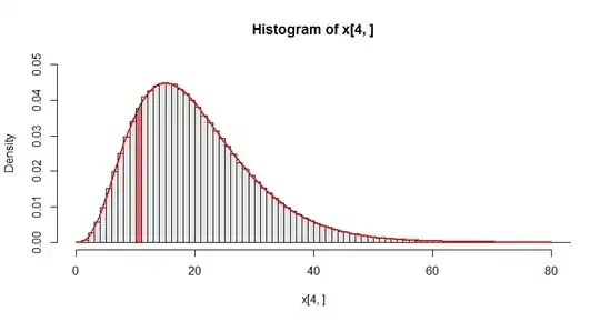

The comparison between the Gamma PDF and our simulation results is excellent. In this figure, the probability asked for in question (a) is the area of the dark red region. We approximated that by the area of a rectangle of almost the same height.
Histogram
From this plot we can read off the probabilities of the fourth animal sighting for any time interval merely by estimating areas. For instance, a fast runner would finish this race in (say) 45 minutes. Their chance of not sighting at least four animals is the area to the right of 45, which looks pretty small--just a few percent. (R computes it as 1 - pgamma(45, 4, rate=1/5), giving $2.1\%$.)
The R code to make this plot (without the highlighted region) is
hist(x[4,], breaks=80, probability=TRUE, xlim=c(0,80), ylim=c(0,0.05), col=rgb(.9,.9,.9))
curve(dgamma(x,4,rate=1/5), add=TRUE, lwd=2, col="Red")
