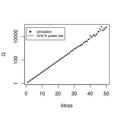

  • computational By simulating a lot of cases I find that the power-law with a factor 5/4 seems correct.
    sim
     # settings
     set.seed(1)
     ktoss <- 1:50
     n <- 10^6
     Q <- rep(0,length(ktoss))
    compute for 1 to 50 tosses n <- 10^6 million trials
    for (k in ktoss) { t <- rbinom(n,k,0.5) Q[k-min(ktoss)+1] <- mean(2^(k-2*t)) }
    plotting
    plot(ktoss,Q, log = "y") lines(ktoss,(5/4)^ktoss)
