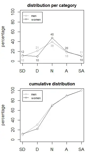

Graphical representation
It may help to plot the percentages of the results.
plots
You can see that for women and men you have more or less similar frequencies in the 'strongly disagree' and in the 'agree' and 'strongly agree' categories. It is in the categories 'disagree' and 'neutral' that you see that men are relatively more often in the disagree category and less often in the neutral category (or from the other perspective women less often in the disagree category and more often in the neutral category).
These differences are not very large. We can also see this based on a chi-squared test for the equivalence of the two distributions ($\chi^2 = 5.9037, df = 4, p = 0.2065$). But it might be interesting for further investigation to see whether men are often less nuanced (less often 'N') in comparison to women, and in place of that more often slightly negative (more often 'D').
