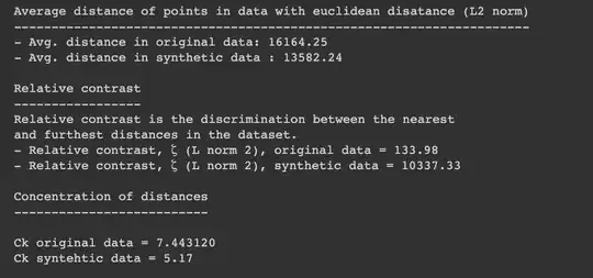

I have found a possible application. After been generated several tabular synthetic datasets I have seen the following: I have used small sample size tabular data (less than 30 samples) and I have generated synthetic data with for example 1000 samples. The relative contrast in synthetic data is much higher than original data. In fact I have seen that this contrast in original data is close to the Ck value (see theorem below).

Example:
Synthetic data created with python library nbsynthetic (https://github.com/NextBrain-ml/nbsynthetic)
Results:
Conclusions:
  • This can be a prove that generated synthetic has higher contrast and is more suitable for finding patterns and quantify it.
  • If Ck values from original and synthetic data are the same ¿does it means both distributions are close? ¿Could me a 'distance metric' to check if synthetic data is 'similar' to original data?
