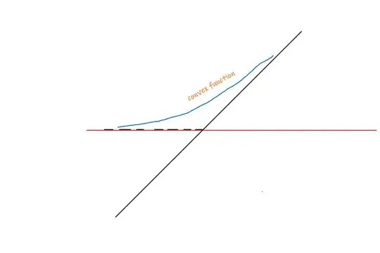

No. Because there is no almost linear, there's only linear or nonlinear. Otherwise, I'd be saying that ReLU is a linear function "because it is always linear with a slope 0 or 1."
ReLU is a nonlinear function with non zero convexity. If you step back you'll see a world of difference between a line and ReLU. ReLU is cousin of a highly convex function. enter image description here Yes, its convexity is concentrated in a small region but that's also what makes it so useful too: your weights "locate" convexities in the domain, helping the NN approximate the shapes so well.
I'd also say that having a protractor is not the same as having only a ruler. You can draw complex surface much faster with a protractor than with only a ruler, because to make a simple angle with only a ruler would require quite a bit of trigonometry while with a protractor it's just a quick single operation.

  • Great answer. But, what is wrong with my mathematical reasoning in my question? – Coder Jun 15 '20 at 00:33
    you are dealing with a piece wise linear function, and looking at each linear piece in isolation - that's what wrong. you can take any continuous function and approximate it with a piece wise linear function, using small pieces. so in your framework of thought what NN accomplishes is that it finds the appropriate knot points and picks the right slopes for each piece. that's quite a bit and that's what a simple linear regression can't do out of the box. – Aksakal Jun 15 '20 at 00:46
