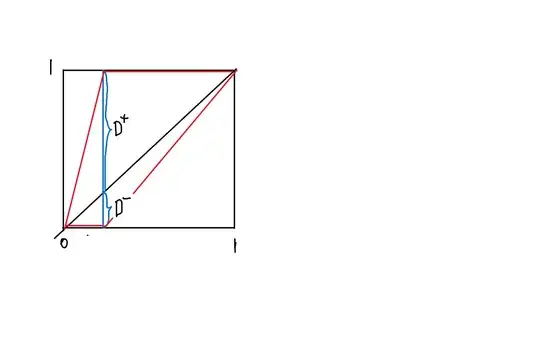

Here's a plot for a uniform distribution CDF (black) and two stylized candidate CDFs (red):
You see that your candidate CDF can't be over the theoretical by more than $D^+$ or below it by more than $D^-$, both of which are bounded in magnitude by 1.
The empirical CDF $S_n$ for the purpose of this test is $S_i=i/N$. Here we sorted the sample $x_i$ where $i=1,\dots,N$ so that $x_i<x_{i+1}$. You compare it with a theoretical CDF $F_i=F(x_i)$, then you have set of deviations $D^+_i=\max(0,S_i-F_i)$.
However, that's not what's amazing about KS statistic. It is that the distribution of $\sup_{x\in(-\infty,\infty)} D^+$ is the same for any distribution of data set! To me that's what you need to get intuitively if you can.

  • Your final remark is important, albeit tangential to the question. But this result is unsurprising, because any continuous monotonic increasing transformation of the distribution (applied at the same time to the data) will not change the KS statistic, since geometrically it changes only the $x$ coordinates, leaving all vertical distances unaffected. Because any continuous CDF can transformed (via its probability integral transform) to a uniform distribution, your picture of the uniform CDF is completely general. – whuber Jun 12 '20 at 21:11
  • BTW, your labels "$D^+$" and "$D^-$" may be confusing to readers, because these terms are usually used for the largest deviations between data and the hypothesized CDF rather than between the CDF and its theoretical limits of $1$ and $0.$ – whuber Jun 12 '20 at 21:13
  • @whuber agreed that notation is confusing, will improve it. – Aksakal Jun 12 '20 at 21:17
