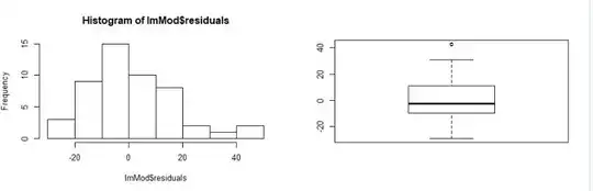

I am trying to learn how to check if the distribution of values in a set is normal or not. Making a histogram and a boxplot shows: enter image description here

Am I correct if I interpret this as: Shapiro-Wilk normality test's H0 is that the population is normally distributed. Because the p-value is less than 0.05 this can be rejected as the chance that the population is normally distributed is too low. Short: The data is not normally distributed?

It's a littlebit rough to say "the chance that the population is normally distributed is too low", however you are right with your short interpretation to assume or interpret that the data is not normally distributed at a significance level of 5% (or even 2.5%).
