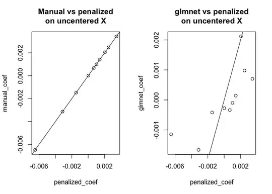

I was recently trying to figure out what glmnet's ridge regression is doing (7,000 lines of Fortran are no fun) and am confused by its behavior with an uncentered design matrix $X$.
I am aware that there are already a lot of questions on differences between glmnet and manual implementations:
The solution usually is that someone forgot to scale $\lambda$ by a factor of $\frac{1}{N}$ or forgot that $y$ is standardized.
However, I try to understand how glmnet handles design matrices with colMeans(X) != 0. I wrote a small script to demonstrate the problem, where I compare my manual implementation with the penalized and the glmnet packages:

plot(penalized_coef, manual_coef, main = "Manual vs penalized\non uncentered X"); abline(0,1)
plot(penalized_coef, glmnet_coef, main = "glmnet vs penalized\non uncentered X"); abline(0,1)

As you can see, for centered $X$ the results agree between all three approaches, however for uncentered $X$ glmnet is doing something different. (I also did check the behavior with standardize = TRUE, but that doesn't change the problem.)
If anyone has some insight on what I missed or what glmnet is doing internally, I would be very thankful :)
const-ae
  • 267
  • glmnet always includes an intercept term. – whuber May 17 '20 at 11:19
  • But what does intercept = FALSE do then? – const-ae May 17 '20 at 12:24
  • As far as I can tell it doesn't do anything--in all my uses of glmnet I have been unable to remove the intercept. – whuber May 17 '20 at 15:56
  • Well, as y is always centered and scaled to unit-variance, for a centered X it makes hardly a difference a difference if you include the intercept. However for uncentered X the coefficients differ depending on intercept: y <- rnorm(2000); X <- matrix(rnorm(n = 2*2000, mean = rep(c(100, 500), each = 2000)), ncol = 2); coef(glmnet(X, y, alpha = 0, lambda = lambda, intercept = TRUE, standardize = FALSE)); #> 2.786449671 0.015280834 -0.008664797; coef(glmnet(X, y, alpha = 0, lambda = lambda, intercept = FALSE, standardize = FALSE)); #> 0.000000e+00 -1.761616e-04 -1.406650e-06 – const-ae May 17 '20 at 21:48
