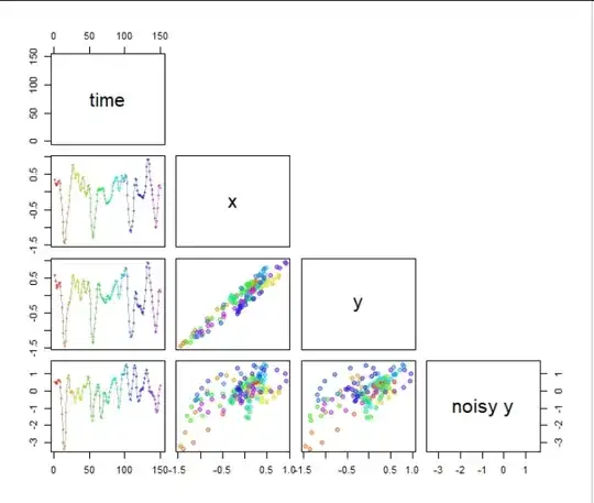

Examples
First, here is the solution using the default white noise.
Figure 1 showing scatterplot matrix of time, x, y, and noisy y
In this scatterplot matrix, the original series $(x_t)$ is at the top upper left plotted against time. It exhibits noticeable positive serial correlation: it's not jagged and random, but smoothly undulating. Beneath it are $(y_t)$ (also serially correlated) and then--this is the first solution, down in the lower left corner--the noisy version of $(y_t).$ (The rest of the matrix displays correlations among the series as scatterplots. The colors consistently show the times.)
The original correlation of $\rho=0.95$ has been reduced to precisely $\kappa \rho = 0.60.$ However, there's a problem: qualitatively, the noisy series doesn't look much like $(y_t).$ It's too jagged.
We solve this by using a noise series that has (approximately) the same serial correlation as $(y_t).$ Here's what the second solution looks like:
Figure 2 showing modified solution in the same way as Figure 1
Look at the lower left corner. Once again, the correlation of this modified series $(y_t^*)$ with $(x_t)$ is precisely $\kappa \rho=0.60.$ If that seems like an improvement, then this method is probably what you want to use.
