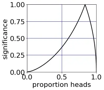

Is it ok if I rephrase the question please, using a different example? Consider my ten thousand friends. They each toss a coin. It's the same coin. I know nothing aboout coins. So I ask one of them, Archer. He got heads. Is it the same question to ask: 'what is the probability distribution of what everyone got?'
I tried a Jeffreys prior and a full range of lower and upper confidence intervals which gave me this: enter image description here
So the significance that nobody, not even Archer, got heads is 0. Fair enough, I believe him. But the significance that everybody, even Archer, got heads is also 0. This needs adjustment.
