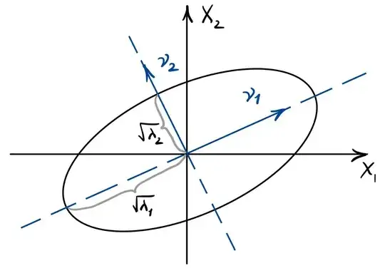

@PAF's answer is good, but I would argue that ellipse's semiaxes correspond to square roots of eigenvalues.
Indeed, the contours of Gaussian distribution with zero mean can be defined by the equation $x^\top \Sigma^{-1} x = \alpha,\, \alpha \in \mathbb{R}$. Let us pick $\alpha=1$. As @PAF pointed out, we can decompose $\Sigma=R\Lambda R^\top\Rightarrow \Sigma^{-1}=R\Lambda^{-1} R^\top$, where $R$ is a rotation matrix. Coordinates in the rotated system $\tilde{x}$ relate to the original coordinates as $x=R\tilde{x}$, and the equation $x^\top \Sigma^{-1} x = 1$ in the new coordinates reads as $$ \tilde{x}^\top \Lambda^{-1} \tilde{x} = \frac{\tilde{x}_1^2}{\lambda_1}+\frac{\tilde{x}_2^2}{\lambda_2} = 1. $$ Compare that to the equation of an ellipse with semiaxes $a$ and $b$, $\frac{\tilde{x}_1^2}{a^2}+\frac{\tilde{x}_2^2}{b^2} = 1$, and we conclude $a=\sqrt{\lambda_1},\; b=\sqrt{\lambda_2}$.
An additional observation is that the eigenvectors $\nu_1, \nu_2$ of $\Sigma$ (i.e., the columns of $R$) will be the basis vectors of the rotated system. enter image description here
