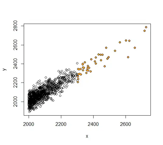

Here are roughly associated $(x,y)$ pairs. The R code below identifies the outliers among the $x$'s and then finds the corresponding $y$'s.
So i think the orange points in the scatterplot (below) are the points of interest. Note that $x$'s (areas) rule, the largest $y$ may not correspond to any $x$ outlier. (You could make a list if you don't want to look at plots.)

x.out   = boxplot.stats(x)$out
y.corsp = y[which(x %in% x.out)]
plot(x,y)
 points(x.out,y.corsp, col="orange", pch=20)
First six orange points in the list.
head(cbind(x.out, y.corsp))
        x.out  y.corsp
[1,] 2305.246 2207.574
[2,] 2432.456 2500.806
[3,] 2342.528 2359.964
[4,] 2368.037 2329.798
[5,] 2622.573 2645.349
[6,] 2365.179 2354.905

  • This doesn't help solve his question. The orange points are not outliers for him. He wants mispriced houses, not big and expensive houses. – javierazcoiti Apr 28 '20 at 10:45
  • He says he wants " to find is cheap houses with huge [expensive] areas." I'll be happy to let OP decide if this is helpful. And delete it if not. – BruceET Apr 28 '20 at 10:50
