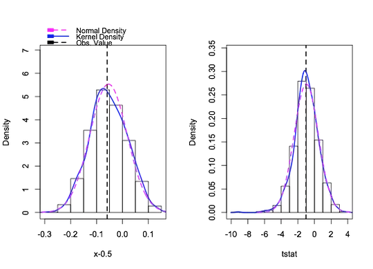

Then boot and check the distribution:
bo <- car::Boot(fit, R=999, f=fun, labels=c("x-0.5","tstat"))
hist(bo, ci="none")
In this case, the method you highlight and the t-statistic will give very similar estimates:
sum(bo$t0[2] > bo$t[,2])/(nrow(bo$t)+1)
[1] 0.492
> sum(bo$t0[1] > bo$t[,1])/(nrow(bo$t)+1)
[1] 0.49
When the sample size is small or you have values that deviate, it will be useful to check how these two differ.
