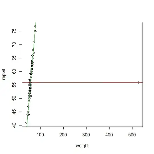

For simple regression (single x), there's something to be said for the Theil-Sen line in terms of robustness to y-outliers and to influential points as well as generally good efficiency (at the normal) compared to LS for the slope. The breakdown point for the slope is nearly 30%; as long as the intercept (there are a variety of possible intercepts people have used) doesn't have a lower breakdown, the whole procedure copes with a moderate fraction of contamination quite well.
Its speed might sound like it would be bad - median of $\binom{n}{2}$ slopes looks to be $O(n^2)$ even with an $O(n)$ median - but my recollection is that it can be done more quickly if speed is really an issue ($O(n \log n)$, I believe)
Edit: user603 asked for an advantage of Theil regression over L1 regression. The answer is the other thing I mentioned - influential points:
Theil_vs_L1
The red line is the $L_1$ fit (from the function rq in the quantreg package). The green is a fit with a Theil slope. All it takes is a single typo in the x-value - like typing 533 instead of 53 - and this sort of thing can happen. So the $L_1$ fit isn't robust to a single typo in the x-space.
Glen_b
  • 282,281
  • it can indeed be computed in time $n\log n$. Could you elaborate on what advantage (in the single x case) the T-S estimator has over, say, $l_1$ regression? – user603 Mar 10 '13 at 09:39
    @user603 See the edit. – Glen_b Mar 10 '13 at 11:28
  • (+1) thanks for the edit. It's important to point this feature out. – user603 Mar 11 '13 at 09:27
