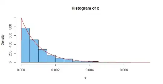

In view of the first link, consider the following simulation, in which distances between sorted uniformly distributed points in $(0,1)$ are exponentially distributed. (The simulation cheats slightly because there are exactly 1000 points.)
set.seed(2020)
u = runif(1000)
x = diff(sort(u))
hist(x, prob=T, ylim=c(0,1000), col="skyblue2")
  curve(dexp(x, 1000), add=T, col="red", n=10001)
BruceET
