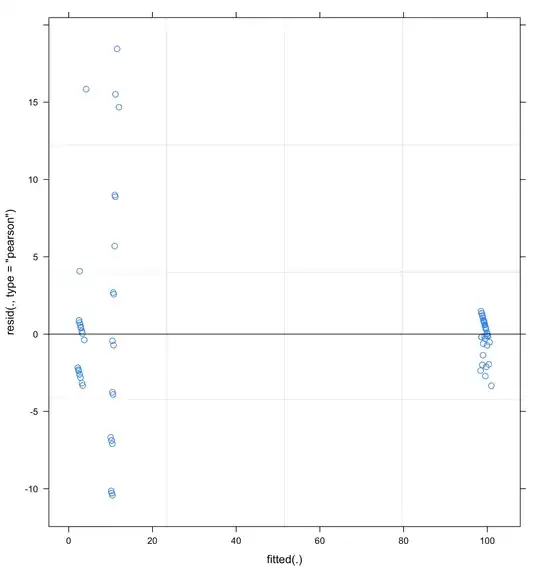

Plus, when I plot the residuals vs fitted, there is some large y axis data point and data point don't tend to cluster towards the middle of the plot at all. But I mean, my data are like this, with two of the conditions inducing almost always 100 % of responses and the 2 others inducing near 0% of responses and nothing in the middle.

EDIT: My data are binomial and I should not have done lmer in the first place, but glmer with family=binomial and a logit link. Works much better that way !

  • That histogram says it all. You do not have a unimodal distribution. lm and lmer and their offshoots are designed to model unimodal distributions or 0/1, count, rates, etc. You have a bimodal distribution, which could could be a mixture of two normal distributions. See https://stats.stackexchange.com/questions/310064/mixture-models-vs-mixed-models for a start. – Erik Ruzek Apr 14 '20 at 16:10

  • The residuals plot density shows that the distribution is not binomial (see post), so should I still do a mixted effect mixture model? – Emilie Durosoir Apr 14 '20 at 17:25
  • The q-q plot shows that you have major issues with the residuals from a linear model. That, combined with the density plot of your outcome, suggest that you need a different approach. I do not know much about multilevel mixture models, I'm afraid. The one program I know you can estimate them in is Mplus, but that is not freeware. There is a student version you can play with that limits you to seven variables, I think. – Erik Ruzek Apr 14 '20 at 18:08
