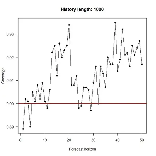

All that said, why do you want to fit an ARIMA model? Most people will want to do so to forecast. (Yes, there are also other motivations.) In this case, it would make sense to expand your experiments to also include the forecasting step. This is what I do below. I simulated 100 (or 1000) historical data points plus 50 holdout data points using arima.sim(), then fitted an ARIMA model using auto.arima(), calculated 90% interval forecasts using forecast(), counted how often these interval forecasts covered the true value and finally plotted the average coverage against the forecast horizon. Results and code are below. It would seem to me that at least the interval forecasts are "good enough". (The apparent upward trend in the plot for a history length of 100 looks intriguing. I don't know where it comes from.)
coverage_100
coverage_1000
library(forecast)
n_sims <- 1000
n_history <- 100
n_forecast <- 50
true_model <- list(ar=c(0.3,0.5))
confidence_level <- 0.9
hit <- matrix(NA,nrow=n_sims,ncol=n_forecast)
pb <- winProgressBar(max=n_sims)
for ( ii in 1:n_sims ) {
    setWinProgressBar(pb,ii,paste(ii,"of",n_sims))
    set.seed(ii)    # for reproducibility
    actuals <- arima.sim(model=true_model,n=n_history+n_forecast)
    model <- auto.arima(actuals[1:n_history])
    fcst <- forecast(model,h=n_forecast,level=confidence_level)
    hit[ii,] <- fcst$lower<=tail(actuals,n_forecast) & tail(actuals,n_forecast)<=fcst$upper
close(pb)
coverage <- apply(hit,2,sum)/n_sims
plot(coverage,xlab="Forecast horizon",ylab="Coverage",las=1,
    main=paste("History length:",n_history),
    type="o",pch=19,ylim=range(c(coverage,confidence_level)))
abline(h=confidence_level,lwd=2,col="red")
