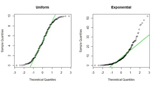

Results for nonnormal data. We show results of the Shapiro-Wilk test for samples from normal and exponential populations.
set.seed(407)
u = runif(200, 0, 10)
summary(u); sd(u)
Min. 1st Qu. Median Mean 3rd Qu. Max.
0.02289 2.32162 4.74545 4.94375 7.64946 9.96443
[1] 3.02981
shapiro.test(u)
Shapiro-Wilk normality test
data: u
W = 0.94561, p-value = 7.288e-07
set.seed(408)
v = rexp(200, 1/10)
summary(v); sd(v)
0.03374 2.69530 6.46082 9.81964 13.56134 52.08287
[1] 9.959839
shapiro.test(v)
data: v
W = 0.81954, p-value = 1.773e-14
