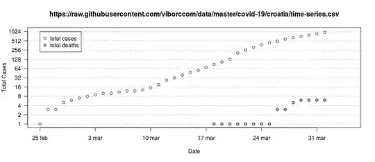

    See the past reports on the cases below. The curve is not a nice straight line and is varying in growth rate and bumpy. It is very difficult to make a specific relation between specific events and this curve. That is because the time between infection, start of symptoms, and start of registration/confirmation occurs with an unknown delay.
    cases
