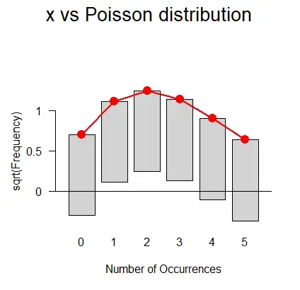

One can formally test the fit of the data to the theoretical poisson distribution using a chi-squared goodness of fit test, via the goodfit() function included in the vcd package.

    require(vcd)
    x=0:5
    freqx=c(7,12,7,3,1,1) # Counts at each level of x
    gf = goodfit (x, type= "poisson", method= "ML")
summary(gf)
    Goodness-of-fit test for poisson distribution
                      X^2 Likelihood Ratio = 1.91, df = 4, P(> X^2) = 0.75
plot (gf, main= "x vs Poisson distribution")
In plots such as these from vcd, bars lifted above the x-axis reflect negative residuals (too few occurrences to fit the theoretical distribution); bars that extend below, positive residuals (too many). This may seem less than intuitive, and the plot can't be modified in some of the usual ways (text size relative to bar size, etc), and so the following approach may be more helpful.

rolando2
  • 12,511
  • freqx=c(7,12,7,3,1,1) # Counts at each level of x x is the individual groups right? Just to be sure :) – Lars Nielsen Mar 27 '20 at 10:00
    @LarsNielsen - x is the value at which we observe a certain count: in these plots, x = "Number of Occurences" while "Freqx" = the count of the number of times we observe such a number of occurrences. 0 occurrences happened 7 times, etc. I left vcd's default labels as they are, though I'm sure you could improve on them. Cheers ~ – rolando2 Mar 27 '20 at 10:17
