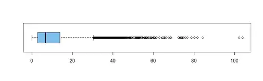

Nor does a boxplot do a useful job of identifying outliers here.
boxplot(x, horizontal=T, col="skyblue2")
For many practical purposes, a 'corrected' right-skewed dataset (devoid of its naturally-occurring high values) would give a seriously misleading impression.
Systematic pruning of 'outliers' is very frequently a bad idea, whatever criterion is used to 'identify' them.
If you could discuss your purpose in trying to get rid of outliers, perhaps we could be more helpful.

  • The purpose is actually not getting rid of any outliers, just identifying them. Further down maybe some manual investigation is done. Do you mind elaborating the sentence with "...'correct' right skewed dataset"? – MLEN Mar 25 '20 at 18:45
  • My point was the my data were generated from the skewed exponential distribution. So the sample naturally has a long tail to the right and what appear to be outliers are giving correct information. – BruceET Mar 26 '20 at 17:11
