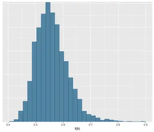

Because this problem really relies on a single assertion (namely, that $c$ has some value), we can simply estimate the following model
$$ y \sim \mathcal{N}(b_0 + b_1x, \sigma)$$
and determine the posterior probability that either $b_0/(b_0+b_1)<c$ or $b_0/(b_0+b_1)>c$. Here is an example. Say we had a hypothesis that $c=1$ and we know that the variance is 4 and that the intercept (or the mean of one populatio
n) is 2. We can fit the following model in Stan

This will allow is to freely estimate the parameter $b1$ assuming we know $b_0$ and $\sigma$. After fitting the model with a standard normal prior on $b_1$, here is a histogram of the posterior
The model provides a 95% posterior credible interval for $c$ covering (0.465, 0.686). We can be fairly certain that the value of $c$ is not 1.
  • You can’t use credible regions to test a point null. The fact that $1$ lies outside a credible region tells nothing about the relative plausibility of $c=1$ to $c\neq 1$ or an error rate associated with any decision procedure associated with $c$. – innisfree May 17 '20 at 06:33
  • On top those those two problems, the procedure depends on an ordering rule for the credible region, and worse still, isn’t necessarily invariant under reparameterisations of the problem. – innisfree May 17 '20 at 06:37
