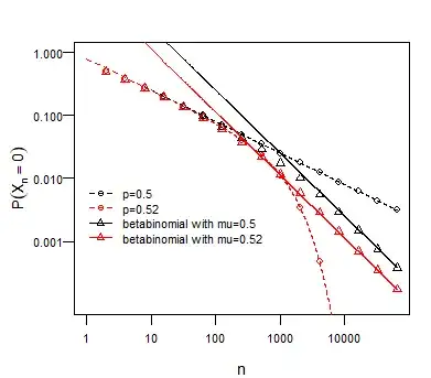

Example plot
The different cases are plotted in the graph below. For the case 1 there is a variation depending on whether $p=0.5$ or $p\neq 0.5$. In the example we plotted $p=0.52$ along with $p=0.5$. You can see that this already makes a large difference.
You could say that for a $p \neq 0.5$ the probability that the vote matters is very tiny and drops dramatically for already $n>100$. In the plot you see the example with $p=0.52$. However, it is not realistic that this probability is fixed. Consider for instance swing states in the US presidential elections. From year to year you see a variation in the tendencies how states vote. That variation is not due to the random behaviour of the $X_i$ according to some Bernoulli distribution, but instead it is due to the random behaviour of $p$ (ie. the changes in the political climate). In the plot you can see what would happen for a beta-binomial distributed variable where the mean of $p$ is equal to 0.52. Now you can see that, for higher values of $n$, the probability for a tie is a bit higher. Also the actual value of the mean of $p$ is not so much important, but instead much more important is how much it is dispersed.
R-Code to replicate the image:
p = 0.52
q = 1-p
compute probability of a tie
n <- 2 ^ c(1:16)
y <- dbinom(n/2,n,0.5)
y2 <- dbinom(n/2,n,p)
y3 <- dbetabinom(n/2,n,0.5,1000)
y4 <- dbetabinom(n/2,n,0.52,1000)
plotting
plot(n,y, ylim = c(0.0001,1), xlim=c(1,max(n)), log = "xy", yaxt="n", xaxt = "n",
ylab = bquote(P(X[n]==0)),cex.lab=0.9,cex.axis=0.7,
cex=0.8)
axis(1 ,c(1,10,100,1000,10000),cex.axis=0.7)
axis(2,las=2,c(1,0.1,0.01,0.001),cex.axis=0.7)
points(n,y2, col=2, cex = 0.8)
points(n,y3, col=1, pch=2, cex = 0.8)
points(n,y4, col=2, pch=2, cex = 0.8)
x <- seq(1,max(n),1)
compare with estimates
binomial distribution with equal probability
lines(x,sqrt(2/pi/x) ,col=1,lty=2)
binomial distribution with probability p
lines(x,1/sqrt(2pipq)/sqrt(x) exp(-0.5(p-0.5)^2/(pq)*x),col=2,lty=2)
betabinomial distribution with dispersion parameter 1000
lines(x, dbeta(0.5,0.51000,0.51000)/x ,col=1)
lines(x, dbeta(0.5,0.521000,0.481000)/x ,col=2)
legend(1,10^-2, c("p=0.5", "p=0.52", "betabinomial with mu=0.5", "betabinomial with mu=0.52"), col=c(1,2,1,2), lty=c(2,2,1,1), pch=c(1,1,2,2),
box.col=0, cex= 0.7)
