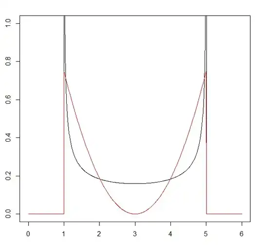

Here are two possible densities, a beta distribution in black (though at $1$ and $5$ the densities approach $\infty$) and a parabolic distribution in red (though at $1$ and $5$ the densities approach $\frac34$) so it rather depends on what limits you want at the extremes
using R code
dstretchbeta <- function(x){(1/4)*dbeta((x-1)/4, 1/2, 1/2)}
dparabola <- function(x){ifelse(x < 1 | x > 5, 0, (3/16)*(x-3)^2)}
curve(dstretchbeta, from=0, to=6, ylim=c(0,1))
curve(dparabola, from=0, to=6, col="red", add=TRUE)
Henry

  • Thank you so much for this!. How can I remove the lines from the curve at 1 and 5? – hana Feb 08 '20 at 10:54
  • @ghana In the R code, using from=1, to=5, instead of the two from=0, to=6, will avoid the vertical and straight horizontal lines – Henry Feb 08 '20 at 12:04
  • Thank you @Henry. Do you know the equivalent to dbeta in Python? I tried 1/4*beta.pdf((1-x)/4,0.5,0.5,1,5) from scipy.stats but it gives me 0 always! – hana Feb 08 '20 at 21:00
  • @ghana It should probably be (x-1)/4 rather than (1-x)/4 but I do not know this part of Python, as I found early courses in it less statistician friendly than R – Henry Feb 08 '20 at 21:08
  • Thank you. It works finally x = np.linspace(1,5,1000) y= 1/4 * beta.pdf((x-1)/4,a=0.5,b=0.5) plt.ylim(0,1) plt.plot(x,y) – hana Feb 08 '20 at 22:29
