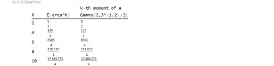

But do higher order moments now match? Yes.
TableForm[
 Table[{2 k, Expectation[area^(2 k),
    Table[x[i] \[Distributed] NormalDistribution[0, 1], {i, 9}]],
   Expectation[z^(2 k), z \[Distributed] GammaDistribution[2, Sqrt[3]/2]]}, {k, 1, 5}],
 TableHeadings -> {None, {"\nk", "\nE[area^k]", "k-th moment of a\nGamma(2,3^(1/2)/2)"}}]
Table of matching even moments
It looks like a Gamma and we can match (eventually) many even moments.
This doesn't get you a proof but if the distribution of the area is really a multiple of a Gamma distribution, then that might suggest some avenues to go about getting a proof to others. (This approach will almost certainly apply to your cross-product questions on several of these forums.)
