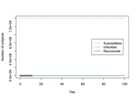

I am trying to calculate the basic reproduction number $R_0$ of the new 2019-nCoV virus by fitting a SIR model to the current data. My code is based on https://arxiv.org/pdf/1605.01931.pdf, p. 11ff:
library(deSolve)
library(RColorBrewer)
#https://en.wikipedia.org/wiki/Timeline_of_the_2019%E2%80%9320_Wuhan_coronavirus_outbreak#Cases_Chronology_in_Mainland_China
Infected <- c(45, 62, 121, 198, 291, 440, 571, 830, 1287, 1975, 2744, 4515)
day <- 0:(length(Infected)-1)
N <- 1400000000 #pop of china
init <- c(S = N-1, I = 1, R = 0)
plot(day, Infected)
SIR <- function(time, state, parameters) {
  par <- as.list(c(state, parameters))
  with(par, { dS <- -beta * S * I
  dI <- beta * S * I - gamma * I
  dR <- gamma * I
  list(c(dS, dI, dR))
RSS.SIR <- function(parameters) {
  names(parameters) <- c("beta", "gamma")
  out <- ode(y = init, times = day, func = SIR, parms = parameters)
  fit <- out[ , 3]
  RSS <- sum((Infected - fit)^2)
  return(RSS)
lower = c(0, 0)
upper = c(0.1, 0.5)
set.seed(12)
Opt <- optim(c(0.001, 0.4), RSS.SIR, method = "L-BFGS-B", lower = lower, upper = upper)
Opt$message
## [1] "NEW_X"
Opt_par <- Opt$par
names(Opt_par) <- c("beta", "gamma")
Opt_par
##      beta     gamma
## 0.0000000 0.4438188
t <- seq(0, 100, length = 100)
fit <- data.frame(ode(y = init, times = t, func = SIR, parms = Opt_par))
col <- brewer.pal(4, "GnBu")[-1]
matplot(fit$time, fit[ , 2:4], type = "l", xlab = "Day", ylab = "Number of subjects", lwd = 2, lty = 1, col = col)
points(day, Infected)
legend("right", c("Susceptibles", "Infecteds", "Recovereds"), lty = 1, lwd = 2, col = col, inset = 0.05)
R0 <- N * Opt_par[1] / Opt_par[2]
names(R0) <- "R0"
R0
## R0
##  0
I also tried fitting with GAs (as in the paper), also to no avail.
My question
Am I making any mistakes or is there just not enough data yet? Or is the SIR model too simple? I would appreciate suggestions on how to change the code so that I get some sensible numbers out of it.
Addendum

    You may want to try a SEIR model (Susceptible-Exposed-Infectious-Recovered), because the nCov virus has a significant incubation period. – dain Jan 28 '20 at 21:18
  • @dain: Thank you... how has the SIR model to be enhanced to become a SEIR model? – vonjd Jan 29 '20 at 01:04
    @vonjd in your blog you write that your fit results in $R_0 \approx 2$. Note that this is only because the optim function terminates too early. Below I am showing a graph with a solution $R_0 \approx 1.005$, which makes a better fit (I have also added the code to get to it by using the itterative solver, which is the most robust). – Sextus Empiricus Feb 12 '20 at 15:52
5 Answers5
26
There are several points that you can improve in the code
Wrong boundary conditions
Your model is fixed to I=1 for time zero. You can either changes this point to the observed value or add a parameter in the model that shifts the time accordingly.
# should be
init <- c(S = N-Infected[1], I = Infected[1], R = 0)

How is R0 estimated?
The graph above (which is repeated below) showed that there is not much variation in the number of 'infected' as a function of $R_0$, and the data of the number of infected people is not providing much information about $R_0$ (except whether or not it is above or below zero).
However, for the SIR model there is a large variation in the number of recovered or the ratio infected/recovered. This is shown in the image below where the model is plotted not only for the number of infected people but also for the number of recovered people. It is such information (as well additional data like detailed information where and when the people got infected and with whom they had contact) that allows the estimate of $R_0$.
exmple
Update
In your blog article you write that the fit is leading to a value of $R_0 \approx 2$.
However that is not the correct solution. You find this value only because the optim is terminating early when it has found a good enough solution and the improvements for given stepsize of the vector $\beta, \gamma$ are getting small.
When you use the nested optimization then you will find a more precise solution with a $R_0$ very close to 1.
We see this value $R_0 \approx 1$ because that is how the (wrong) model is able to get this change in the growth rate into the curve.

If we use the relation between recovered and infected people $R^\prime = c (R_0-1)^{-1} I$ then we also see the opposite, namely a large $R_0$ of around 18:
I <- c(45,62,121,198,291,440,571,830,1287,1975,2744,4515,5974,7711,9692,11791,14380,17205,20440, 24324,28018,31161,34546,37198,40171,42638,44653)
D <- c(2,2,2,3,6,9,17,25,41,56,80,106,132,170,213,259,304,361,425,490,563,637,722,811,908,1016,1113)
R <- c(12,15,19,25,25,25,25,34,38,49,51,60,103,124,171,243,328,475,632,892,1153,1540,2050,2649,3281,3996,4749)
A <- I-D-R
plot(A[-27],diff(R+D))
mod <- lm(diff(R+D) ~ A[-27])
giving:
> const
[1] 0.3577354
> const/mod$coefficients[2]+1
  A[-27]
17.87653
This is a restriction of the SIR model which models $R_0 = \frac{\beta}{\gamma}$ where $\frac{1}{\gamma}$ is the period how long somebody is sick (time from Infected to Recovered) but that may not need to be the time that somebody is infectious. In addition, the compartment models is limited since the age of patients (how long one has been sick) is not taken into account and each age should be considered as a separate compartment.
But in any case. If the numbers from wikipedia are meaningfull (they may be doubted) then only 2% of the active/infected recover daily, and thus the $\gamma$ parameter seems to be small (no matter what model you use).
  • Thank you! One small point: shouldn't it be c(2*coefficients(mod)[2]/N, coefficients(mod)[1]) in the optbin function? – vonjd Jan 28 '20 at 16:45
    @vondj the coefficients(mod)[2] is the exponential factor that relates to $$I' \approx \underbrace{(\beta \cdot N - \gamma)}_{\text{factor in exponential fit}} \cdot I$$ So you have $\text{factor} = \beta \cdot N - \gamma$ And I chose here $\beta = 2\text{factor}/N$ and $\gamma = \text{factor}$. The parameter coefficients(mod)[1] is the starting point (the height) of the exponential curve. – Sextus Empiricus Jan 28 '20 at 16:49
  • Ok, thank you again... I think I included all of your suggestions... yet I still don't get any sensible values out of it (R0 is still infinite)... I think my model cannot be saved :-( – vonjd Jan 28 '20 at 16:52
  • please have a look: http://blog.ephorie.de/wp-content/uploads/2020/01/fitting_2019-nCov_with_optim2.pdf – vonjd Jan 28 '20 at 17:09
    extra note: I like to scale the parameters in the called function instead of via the parscale option. The parscale option does not scale the output of the hessian, which is a bit annoying. – Sextus Empiricus Jan 28 '20 at 17:20
  • pdfs: I think standard markdown with pandoc. – vonjd Jan 28 '20 at 17:25
  • ok, I think I tried both versions now... although this one (scaling in optim) terminates with an error, some kind of fit is produced (although R0 is still Inf): http://blog.ephorie.de/wp-content/uploads/2020/01/fitting_2019-nCov_with_optim2.pdf – vonjd Jan 28 '20 at 17:28
  • This version (scaling in SIR) doesn't work: http://blog.ephorie.de/wp-content/uploads/2020/01/fitting_2019-nCov_with_optim3.pdf – vonjd Jan 28 '20 at 17:29
  • Ah, now variant three works and gives beta=0.8310849 and gamma=0.4137507! Thank you very much for all the effort! – vonjd Jan 28 '20 at 17:45
  • How did you create the two plots on the right? – vonjd Jan 28 '20 at 17:59
    But keep in mind that those two parameters individually have a large error. It will be something like a linear combination of the two (something close to $\beta-\gamma$ or $\beta/N -\gamma $, depending on the scaling) which will be approximated with high accuracy. – Sextus Empiricus Jan 28 '20 at 17:59
    The plot on the right is log-scale. – Sextus Empiricus Jan 28 '20 at 18:02

You might be experiencing numerical issues due to the very large population size $N$, which will force the estimate of $\beta$ to be very close to zero. You could re-parameterise the model as \begin{align} {\mathrm d S \over \mathrm d t} &= -\beta {S I / N}\\[1.5ex] {\mathrm d I \over \mathrm d t} &= \beta {S I / N} - \gamma I \\[1.5ex] {\mathrm d R \over \mathrm d t} &= \gamma I \\ \end{align}
This will make the estimate of $\beta$ larger so hopefully you'll get something more sensible out of the optimisation.
In this context the SIR model is useful but it only gives a very crude fit to these data (it assumes that the whole population of China mixes homogenously). It's perhaps not too bad as a first attempt at analysis. Ideally you would want some kind of spatial or network model that would better reflect the true contact structure in the population. For example, a metapopulation model as described in Program 7.2 and the accompanying book (Modeling Infectious Diseases in Humans and Animals, Keeling & Rohani). However this approach would require much more work and also some data on the population structure. An approximate alternative could be to replace the $I$ in $\beta SI/N$ (in both of the first two equations) with $I^\delta$ where $\delta$, which is probably $<1$, is a third parameter to be estimated. Such a model tries to capture the fact that the force of infection on a susceptible increases less than linearly with the number of infecteds $I$, while avoiding specification of an explicit population structure. For more details on this approach, see e.g. Hochberg, Non-linear transmission rates and the dynamics of infectious disease, Journal of Theoretical Biology 153:301-321.
S. Catterall
  • 3,927
Because the population of china is so huge, the parameters will be very small.
Since we are in the early days of the infection, and because N is so big, then $S(t)I(t)/N \ll 1$. It could me more reasonable to assume that at this stage of the infection, the number of infected people is approximately exponential, and fit a much simpler model.
