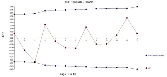

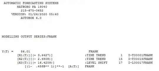

A useful model for these 33 observations is here enter image description here suggesting two time trends and 1 level/step shift along with a (1,0,0) arima structure. The model is here enter image description here
With Actual/Fit and Forecast here enter image description here and
Model residuals here enter image description here and acf here suggesting model sufficiency enter image description here.
The data is clearly non-stationary AND the remedy is NOT DIFFERENCING but detrending and incorporating a level shift (intercept change) . Both deterministic time trends and level/step shifts are the CAUSE of the non-stationarity.
Following is a presentation of the empirically identified " 3 causal series" ... ... two trends and 1 level/step shift enter image description here , showing 33 periods of history and forecasts .
