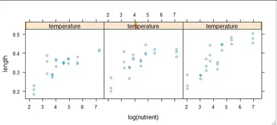

If you do as was suggested in a comment by Michael Lew and use log(nutrient) in the plot, you see a reasonably linear trend for each temperature:
lattice::xyplot(length ~ log(nutrient) | temperature, data = mydata)
scatterplot with log(nutrient)
Accordingly, I tried the following model, which fits quite well:
mylm = lm(length ~ factor(temperature) * log(nutrient), data = mydata)

  • It "hurts" in that it is an arbitrary function (just like a line, albeit with one additional parameter), and you are teaching people to replace one arbitrary function with another in belief that this will produce a model with explanatory or predictive value (a belief which is only true if the data are approximately quadratic: the OP's aren't). – Alexis Jan 26 '20 at 16:39
  • @Alexis I’m skeptical that Type I or Type II error rates would be much different, and quadratic term is closest to what OP was doing. Agree to disagree—all models are wrong, but a the quadratic term can be useful, depending on the situation. The linear mode is pretty robust, in my opinion. – Mark White Jan 26 '20 at 16:40
