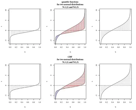

A geometrical intuition
A geometrical intuition to accompany Whuber's answer is the following:
geometric intuition
It relates to answers to other questions here and here.
The mean of the variable relates to the area of the gray striped surfaces, which can be computed in two directions
  • The vertical stripes: as an integral of the quantile function with the quantiles $dp$ as integrand
    $$E[X] = \int_0^1 Q_X(p) dp$$
  • The horizontal stripes: as an integral with the CDF and the variable $dz$ as integrand
    $$E[X] = -\int_{-\infty}^0 F_X(z) dz + \int_{0}^{\infty} 1-F_X(z) dz$$
Then the difference $E[X]-E[Y]$ is
$$\begin{array}{} E[X]-E[Y] &=& \int_{0}^1 Q_X(p)-Q_Y(p) dp \\ \end{array}$$
which relates to the difference of the quantile functions, and the blue and red areas marked by the vertical stripes.
But we can just as well compute this in the horizontal direction by taking the difference between the CDF functions.
$$\begin{array}{} E[X]-E[Y] &=& -\int_{-\infty}^0 F_X(z)-F_Y(z) dz + \int_{0}^{\infty} -F_X(z)+F_Y(z) dz \\ &=& - \int_{-\infty}^\infty F_X(z)-F_Y(z) dz \end{array}$$
