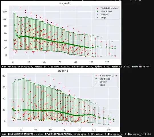

Example The data in example is simulated: 2 independent variables - stage (categorical) and age (axis X), axis Y is the predicted value. The bounds and mean created by 3 separate quantile models. But real data is much more complex, so separate models approach not creating nice results. image
