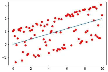

Example 2: Bimodal residuals (high kurtosis)
Here I sampled the residuals from a beta distribution. Again, they are centered around 0 and with variance 1 and yet, this is a very bad model.

  • @peuph - The second distribution is perfectly pertinent, it's a linear function with added noise with 0 mean and variance 1, coming from a beta distribution. Shows quite clearly why only fixing the first two moments is not enough. – Davide ND Dec 20 '19 at 10:35
  • I changed the params of the beta so it's a little less split, hope it helps show my point.. – Davide ND Dec 20 '19 at 10:39
  • @DavideDN Sorry I don't understand your point – beuhbbb Dec 20 '19 at 10:43
  • @peuph My point is simply that fixing the first two moments is not enough. Even though through OLS you do have the Best Linear Unbiased Estimator (both of the one in the pics are unbiased), they are far from being good regresison models. And you actually explained the reason below - it is quite evident that the likelyhood of a sample being on the regression line in those examples is extremely low, as OLS did not correspond to MLE for those. – Davide ND Dec 20 '19 at 10:58

  • From a mathematical perspective, a point on the blue line would have a very low Likelihood in both cases. If you're using the blue line to predict you're actually picking up points that "stand out" from the actual distribution, which is usually not what you're aiming for. – Davide ND Dec 23 '19 at 18:20
