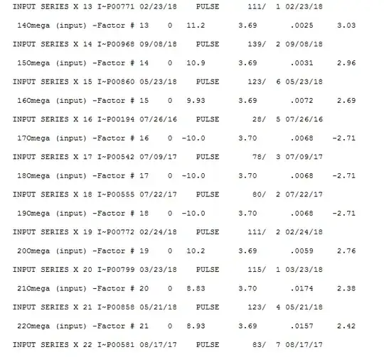

I took your 981 daily values enter image description here and used AUTOBOX ( a piece of forecasting software that I have helped to develop) . The original data visually suggests level shifts ( up at period 560 down at period 801 ) which was confirmed here in a useful model also containing German holiday effects enter image description here AND monthly effects enter image description here enter image description here and here enter image description here

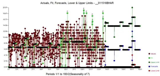

The Actual/Fit and Forecast graph is here enter image description here
The model residual plot enter image description here and ACF plot suggest model sufficiency enter image description here

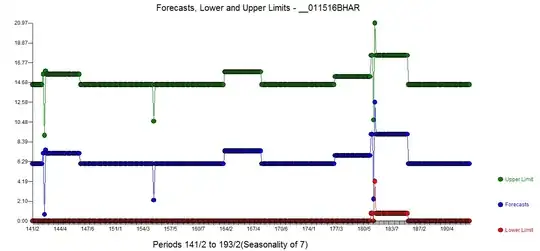

The forecast plot is here emphasizing the monthly effects and the holiday effects along with the level shift effects
Hope this helps you and others dealing with the need to develop daily forecasts.
There is no need for any ARIMA structure . . Your arima model has self-cancelling structure (2,0,2) and there is no need for seasonal differencing once you incorporate the 4 fixed monthly effects.
EDITED AFTER RECEIPT OF OP'S QUESTIONS/COMMENTS
For example a model of the form (1-.5b)z(t)=(1-.5b)a(t) has self cancelling structure . auto.arima is simple trial& error where unwarranted ar structure or unwarranted differencing often generates unwarranted ma structure and unwarranted complexity with consequently wider prediction limits due to over-parameterization.
GIVEN that you KNOW how many level shifts occurred and when ;… GIVEN that you KNOW that 4 and only 4 specified months of the year are important; GIVEN that you KNOW which holidays and what days around the holidays are important and ; GIVEN that you KNOW what time period/points are Outliers ( one-time anomalies) you can certainly use auto.arima without penalty on the residuals from all of the these effects OR even better examine the acf/pacf of the residuals and self-determine the form of the arima structure.
In summary adjust for all the KNOWN effects and examine the residuals ( i.e. the adjusted Y's) to investigate what arima structure is necessary THEN re-estimate with all of the structure and test significance of each and every coefficient ... stepping down appropriately.
