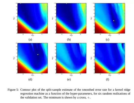

One thing that is not widely appreciated is that over-fitting the model selection criteria (e.g. validation set performance) can result in a model that over-fits the training data or it can result in a model that underfits the training data.
This example is from my paper (with Mrs Marsupial)
Gavin C. Cawley, Nicola L. C. Talbot, "On Over-fitting in Model Selection and Subsequent Selection Bias in Performance Evaluation", Journal of Machine Learning Research, 11(70):2079−2107, 2010. (www)
Here is a heat-map for the model selection criteria for tuning the hyper-parameters of a Least-Squares Support Vector Machine (or Kernel Ridge Regression model) with different training & validation samples. The training set of 256 patterns is identical each time, but a new sample of 64 patterns is used for each validation set. The criterion is a smoothed error rate on the validation set. You can see there is considerable variation between splits in the optimal hyper-parameters (yellow crosses)
Here are the corresponding models, as you can see there is large variation in whether the models over- or under-fit the data.
If you set the hyper-parameters in the position shown in (d) you tend to get a sensible model for all training-test splits, which suggest the problem is in over-fitting the model selection criterion. In this case, as it is only the validation set that changes, we know this is purely due to over-fitting the validation set during model selection.

  • @user2338823 It is probably best to ask the questions in the comments, rather than editing the answer. In these simulations, the training set of 256 patterns is fixed, so the differences are purely due to the sampling of the 64 pattern validation set. It would not be a good idea to control for duplicates because the aim is to assess the effect of sampling variation, and it is no longer an i.i.d. sample if we had controlled for duplicates. Also there will be no exact duplicates as the data are continuous values sampled from a set of normal distributions. – Dikran Marsupial Nov 22 '21 at 08:40

  • "Type 1: Train set consists mostly of "easy to classify" examples" in the simulations, the training set is identical in each case (look at some of the outlying patterns and you will see that they are the same in each diagram). The differences are purely due to the different samples making up the validation sets. – Dikran Marsupial Nov 22 '21 at 12:47
