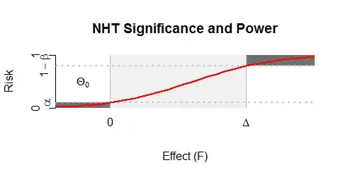

Figure 1 shows a textbook case where $\Theta_0$ is the set of Normal$(\mu,\sigma^2/n)$ distributions with $\mu \le 0$ and $\Theta_A$ is the set of Normal$(\mu,\sigma^2/n)$ distributions with $\mu\gt 0;$ both $\sigma^2$ and $n$ are fixed. The procedure is the usual "Z test." ($n$ is a potential sample size; varying $n$ causes the risk to change, enabling one to determine a sample size that makes the risk function acceptably low.)
Risk function
The red curve graphs $r_t(F)$ (where $F$ can be identified with a multiple of the parameter $\mu,$ termed the "effect"). $\Theta_0$ therefore corresponds to the points on the horizontal ($F$) axis at or to the left of $0.$ The test has been chosen so that the highest point on the graph for $\Theta_0$ is $\alpha=0.10.$
The backgrounds summarize the conversation between statistician and client:
  • The black rectangle at the left is the region where the risk does not exceed $\alpha=0.10$ for the null hypothesis.
  • The black rectangle at the right is a region within the alternative hypothesis where the risk does not exceed a value $\beta=0.20.$
  • The gray rectangle is a "gray area" between these regions where no restrictions are placed on the risk.
The client has selected $\alpha,$ $\beta,$ and the left hand limit $\Delta$ of the right black rectangle. This value $\Delta$ is an "effect size." We may characterize the states of nature with $\mu \ge \Delta$ as being "extreme" because they differ most substantially from any state in the null hypothesis. By limiting the risk in the extreme states we are, in a way, modifying (or weighting) the loss function to reflect a sense that false positive errors made for extreme states are worse than false positive errors made for states in the intermediate gray area.
What this test accomplishes, then, can be stated as follows:
The test $t$ is a procedure that limits the risk to $\alpha$ for the null hypothesis and limits it to $\beta$ for the "more extreme" parts of the alternative hypothesis.
It is conceptually very useful to keep Figure 1 in mind when thinking about NHTs, for it shows clearly that although the error rates are controlled, they nevertheless depend on the true (but still unknown!) state of nature.
This figure is usually drawn by flipping the risk upside-down in the alternative hypothesis, as in Figure 2:
Power curve
This "power curve" is simply the chance of making a "reject" decision. By comparing this figure to the previous one, you can see that where the power is high, the chance of making a false negative error is low. Because the test is constructed to assure the chance of a "reject" is low throughout $\Theta_0,$ often the power curve isn't even plotted for the null hypothesis: it simply is summarized by the test size $\alpha.$ The "significance level" of the test is just $1-\alpha,$ or $90\%$ in this example.
