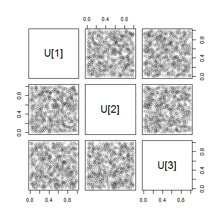

    This argument will not convince some people, who will (rightly) argue that the lack of independence is so slight that it couldn't possibly matter. Allow me, then, to exhibit an example involving a sequence of just three uniform random variables $(U_1,U_2,U_3)$ that behave as described but are demonstrably not independent. Here is a scatterplot matrix of the first thousand realizations showing how the pairs $(U_i,U_{i-1})$ are uniformly filling the unit square:
    scatterplot matrix

    Here is how the variables were generated. We begin with a set $\Omega$ of integer vectors,
    $$\Omega = \{(0,0,0),\ (0,1,1),\ (1,0,1),\ (1,1,0)\},$$
    and give it the uniform probability distribution (so each element is chosen with $1/4$ probability).
    To create one realization of $(U_1,U_2,U_3),$ take an infinite sequence $(\omega_i),i=1,2,\ldots,n,\ldots$ of independent draws from $\Omega.$ Writing $\omega_{ij}$ for component $j$ of $\omega_i,$ set
    $$U_i = \sum_{j=1}^\infty \omega_{ij}2^{-j}.$$
    In effect, for each $j$ the sequence $(\omega_{ij})$ is a random string of zeros and ones which is interpreted as the binary representation of a number between $0$ and $1.$ It is obvious--and straightforward to prove--that each $U_i$ has a uniform distribution. (See Method #5 in my post at https://stats.stackexchange.com/a/117711/919 for more explanation and a simulation.)
    Note, however, that the elements of $\Omega$ enjoy an unusual property: any two components of $\omega\in\Omega$ determine the third. (The third equals $1$ when the other two are not equal and otherwise the third equals $0.$) Thus, because almost all possible $U_i$ uniquely determine the sequence of $\omega_{ij}$ in their binary representations, with probability $1$ each is a function of the other two. Consequently, the distribution of (say) $U_3$ conditional on $U_1$ and $U_2$ is a constant, rather than being uniform. This is as far from independence as one can possibly get!
    See the function predict3 in the appendix (below) for how the third of the $U_i$ is computed from the other two: you just represent the two values in binary, work out the corresponding binary representation for the third one, and convert that to a number.
