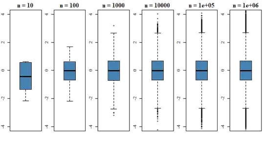

The IQR is the center 50% of the observations. This stabilizes as you increase the sample size, but the first and last 25% do not:
set.seed(1047)
for(i in 1:6){
    x <- rnorm(10^i)
    boxplot(x, ylim = c(-4, 4), col = "steelblue", main = paste("n =", 10^i))
boxplot_IQR
Why? For any continuous distribution from $-\infty$ to $+\infty$, as the sample size increases, so does the chance of observing something further from the center. But the center 50% of a unimodal distribution remains the same. Always extending the whiskers to the extremes makes the boxplot depend heavily on the sample size:
set.seed(1047)
for(i in 1:6){
    x <- rnorm(10^i)
    boxplot(x, ylim = c(-4, 4), col = "steelblue", main = paste("n =", 10^i), range = 0)
boxplot_fullrange
A boxplot based on the IQR is useful when you don't want your visual summary to be (as) dependent on the sample size. I assumed here that you're using a boxplot to visualize observations that come from unimodal distributions, because otherwise a boxplot is not that useful a summary anyway.
