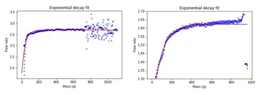

I want to use an exponential decay model in python to relate the flow rate in a device to the mass left inside it, in particular $flow=a−b×e^{−c×mass}$ where a, b and c are the parameters of the model. Here are some of my measurements together with fitted curves.
For a lot of the experimental runs the data points at the start of the experiment would generally behave differently to the rest, which is considered to be due to how different materials begin to flow through the equipment. Sometimes there would be a streak of measurements that are systematically off the trend, other times there would be a megaphone shape with variability slowly decreasing to the level of the rest of the set. Very rarely there are some nonconforming measurements in the end of the experiment (low mass) that need to be trimmed off but usually they are fewer.

One way that came to mind was to fit the model to trimmed data sets and compare the $r^2$ statistic for these models. To explore it visually I made heatmaps of the $r^2$ for different truncations to see if there is a pattern that could justify a trimming strategy. The green tickmarks on the right plots are showing every tenth data point (doesn't look great when there is a lot of data but still). For the cases I've looked at the recommendation of the plot seems to correspond to visual intuition.

  • Visually the data on the right-hand side of the scatterplots appears to approximate a straight line, except for the data to be truncated. My first idea was to linearly fit that data with OLS, and then either iteratively truncate to look for the point when the "straight line" R-squared stopped increasing, or else treat the to-be-truncated data more like a region with outliers to be removed. These methods would both have the effect of removing data points based on their fit characteristics, rather than on experimental characteristics as @Patrick notes in his answer. – James Phillips Oct 23 '19 at 17:17
I believe this to be a bad idea: you are selecting your data based on the data fitting to your model and that can lead to overfitting and possible biases/inaccuracies in your inferences. Basically: how do you know a point is a measurement mistake vs something else just from the value of the point? The recommended practice would be to figure out some sort of indicator in your experiment that can tell you if a point is bad or to improve your experiment so that these bad values don't happen (I know this is easy for a stranger over the internet to say...). One approach would be to try and figure out the measurement uncertainties on each data point (it looks like you have it for some of them but not others) and then try a weighted fit. That would for example solve your problem in some of the cases. You could also experiment with some sort of weighting of the data based on the ease of measurements or something.

1) Make it a piecewise model with a changepoint where you explicitly introduce a measurement error which is dependent on which side of the changepoint you are on. I would personally do this as a Bayesian model using Stan. Something like this: https://ecosang.github.io/blog/study/piecewise-regression-with-stan/ or https://janhove.github.io/analysis/2018/07/04/bayesian-breakpoint-model but instead of letting the parameters vary you let the measurement error vary. Specifically for the second link instead of having a slope_before and a slope_after you would have an error_before and error_after (currently that model just has one error parameter). You would also need to change the functional form of the model (right now it's fitting a piecewise linear regression). You can also change this to incorporate an offset instead of changing the measurement error (so an intercept_before and intercept_after). Heck you could let everything change with the changepoint. You get a lot of flexibility out of this approach.
2) You can fit a changepoint model (e.g., the bcp package in R) on the residuals of your fit and truncate the data after that changepoint and then refit the model. I don't like this approach as much because you're throwing the data out completely but it would solve your problem in an automated way.

  • Hi Patrick, thank you for the suggestion. I share your concerns about the over fitting but my intuition is that it would only cause trouble if I wanted to use my model on the truncated region as well. I am just interested in identifying one that conforms to a trend, and use the model for points in that region alone. I have some idea about what causes the cases where there's a streak of point deviating from the trend at the start, it's not about biased measurements but about the mechanics of the machine. I was thinking I may try to model this effect and your suggestions will be very helpful. – st210 Oct 23 '19 at 14:34
  • In that case I would go with the changepoint analysis to reject data based on fitting the model once, finding the changepoint, and then refitting the model. Check out the bcp package in R or if you're using another language then I'm sure there are packages for that as well. See for example https://github.com/deepcharles/ruptures for python. – Patrick Oct 23 '19 at 14:57
