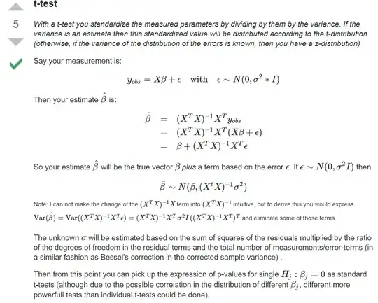

A previous CV post (see also image below) showed that the estimator of a linear regression model is normally distributed, given that the error is normally distributed.
However, the normality assumption of the error term is not really needed in order to make use of p-values given that we have a large sample size $(N>30)$, right? The derivation of the asymptotic normality $\sqrt{T}(\hat{\beta_T}-{\beta}) \rightarrow N(0,\sigma^2)$ did not make use of the normality assumption of the error term. enter image description here

EDIT: Derivation of asymptotic normality of estimator of linear regression only makes use of the mean property:
