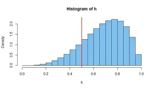

Comment: You have the math in Comments from @Dave and @whuber' link. The initial probability distribution is a beta distribution, specifically $\mathsf{Beta}(2,1).$ Maybe you can match your distribution for $H=X_{(2)}$ to results in the following simulation in R, using a million samples of size $n = 3.$ [With a million iterations you can expect 2, maybe 3, decimal places of accuracy.]
set.seed(928)
h = replicate(10^6, median(rbeta(3, 2, 1)))
mean(h > .5)
[1] 0.843916       # aprx P(H > .5)
2*sd(h>.5)/10^3
[1] 0.0007258703   # 95% margin of sim err for P(H > .5)
27/32
[1] 0.84375        # exact P(H > .5)
mean(h)
[1] 0.685836
hist(h, prob=T, br=30, col="skyblue2")
abline(v = .5, lwd=2, col="red")
